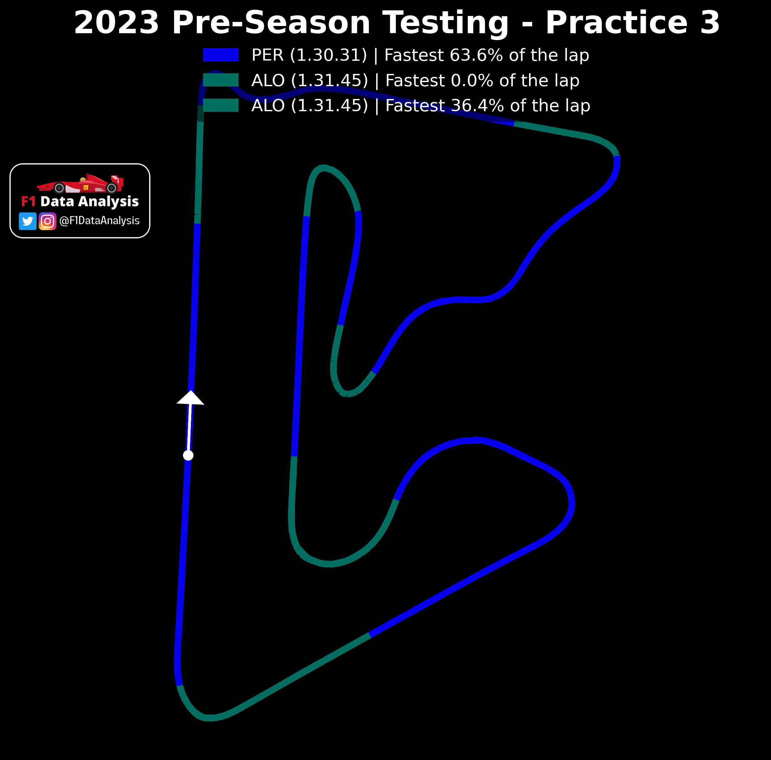

[Imagen: Fp5XEmWXwAIluaL?format=jpg&name=4096x4096]
,There is no doubt that
@AstonMartinF1
built a gem... better than the RedBull in the braking zones while carrying a very similar rear wing!
ALO clocked a time 1.1s slower than PER, and most of the gap was due to the higher drag and lower downforce (look at the faster corners)
